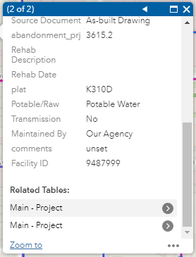

I published a map image layer of our water main pipelines which has two many-to-one relationship classes to a table of project numbers that has as-built drawings as attachments. The primary key for both relationships is a project number field in the project table, and the foreign keys are project number and abandonment project number fields in the water main feature class. In both ArcPro and the web map on our Portal, I can see both relationships and navigate successfully to the corresponding records. However when I view the popup in web appbuilder, it shows two links but they are duplicates of the project number relationship.
If you click either of the Main - Project table links it takes you to only 7159. Another map image layer of laterals correctly displays two separate relationships to project and backflow tables. Is anyone else have issues with multiple relationships to the same table not displaying correctly in web appbuilder?

venkateshkattamuri
This seems to be a strange issue with ArcGIS server, It is happening when I have a combination of Relationship class and Relate in MXD for that feature class.
In this case I have a Feature class with 1 Relationship class (simple) and 3 Other relates in MXD file, when I published this MXD, All relates working fine, but the relationship class is getting generated 4 times.
Refer to below screenshot, which shows 1 Relation ship class and 3 Relates.
This is the relationships list from ArcGIS server directory. The relationship create via Relationship Class (19) got duplicate 3 times.
Here I choose to create relationship class when related table need to be Read/Write, and create in MXD when the related table is read only.
I have tested this multiple times and this is occurring every time when there is combination of Relationship class and Relate.
I am using ArcGIS Enterprise 10.5.1
GavinLemley
Fellow Gavin, here. I had this same issue and just found the solution. You need to remove any layer relates in ArcPro (right click on layer, "Joins and Relates"...) and publish the layer using only relationship classes for your relates. Even though the layer relates don't come through when publishing to AGOL, they seem to somehow remain attached in the background and clash with relationship classes. Hope this works for you too!
