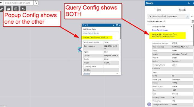

This works GREAT and can be clearly seen in the Popup below... where only one of them is shown at a time...In this case there is a related record for this Feature and as such it says Update for the second link "Update OA-13 Inspection Form"
If there was NOT a related record it would say "Add OA-13 Inspection Record"

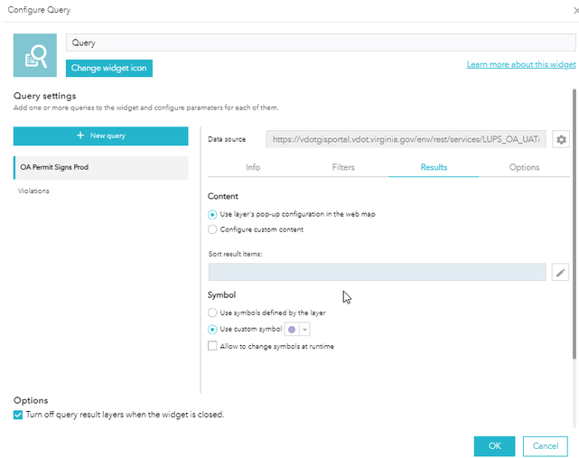

So everything is working Fantastic up to this point... But I then create a Web application and then add the Query Widget.
I configure the Query widget to " Use layer's pop-up configuration in the web map"
Is does this to a certain degree BUT the Expression is not read properly and ALWAYS displays BOTH of the links created via expressions..(See 2nd image below)
No matter what I do I cannot get the QUERY WIDGET to respect the Expressions in the WebMap Custom Config as specified int he Query Widget Config Settings.

I appreciate you sharing the post and providing an excellent details! I understood you have a custom expression which works as expected in Map Viewer but when you create a web app builder using this map, the query widget in web app builder is not honoring this expression.
I went ahead and did some research and found that pop-up configurations made in ArcGIS Online Map Viewer are not compatible with ArcGIS Web AppBuilder. Furthermore, unfortunately, the behavior you are experiencing, looking at your post, seems to be a BUG-000108767: "The Web AppBuilder for ArcGIS Query widget's pop-up does not honor the pop-up configuration of the related table assigned in the ArcGIS Online web map". I can go ahead and attach this bug to our case and you can monitor the status of this bug.
