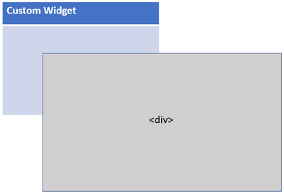

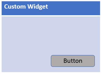

But I meant would look more like this:
I have my custom widget and via button click or whatever event, I pop open a new div - kinda like a menu that opens from a menu bar.
Pretty simple, I figured.
