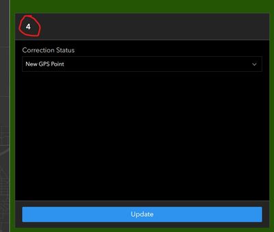

Hello! I am using ArcGIS Experience Builder to create a web map for users to edit attributes of a layer. I added the Edit (Beta) widget and configured everything to work correctly except for one thing: When I click on a feature to edit, it displays the ObjectID (circled in red below) at the top of the Editor widget.
 I would like to change this to a field that is more intuitive to the user. I have scoured the editor widget settings and cannot find where to change this. Any advice would be appreciated!

Possibly this is the popup title configured in the webmap or the data source?
HaydenHarrison1
Thanks for responding. I have the pop up configured to show a different field in the title so I'm not sure that is it.
JRhodes
I'm seeing the exact same behavior. Takes up valuable real estate on mobile screens and provides no useful information to the user.
RobertKGarst
Hello Hayden,
I was having a similar issue and determined that there is a Change Display field that I needed to modify in the REST service to display a desired field.
This is the ESRI technical support document which helped me:
How To: Change Display Field Using ArcGIS Server Services Directory REST API (esri.com)
