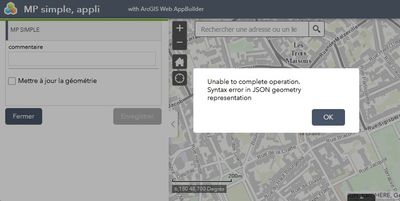

It seems the Web AppBuilder Smart Editor cannot create or modify geometries of multipoint features ... Is anyone else observing this?
I could find no documentation about this limitation, but I replicate this behaviour with the most simplistic feature service: 1 multipoint layer with 1 attribute, no rules, no domains, nothing fancy.

  3. Creating a new point in this multipoint feature service layer throws an error message:
Syntax error in JSON geometry representation

@HélèneTouyéras Your observations are correct, editing the geometry of multipoint features with the Smart Editor is not fully supported, although it seems the user guidance and error messaging around this limitation could be improved.
You will only be able to edit the attributes of existing multipoint features and delete existing multipoint features. You will not be able to create new multipoint features or modify individual point geometries. The limitations should be the same for all multipart features.
I've also just tested this in Portal 10.9.1 and I am observing the same limitations, except that it appears I can create a single point without any errors being displayed.
