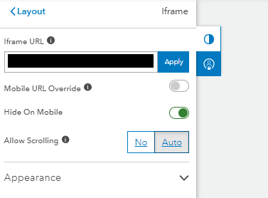

I've created a web mapping application using WAB, and have embedded it into an ArcGIS Hub page. Is it possible to disable scrolling on the map using the mouse wheel? Anytime a user passes over the map, instead of scrolling up/down the page, it zooms in/out of the map, which can be a disruptive experience.
I've created it using the WAB, and unfortunately I'm not familiar with creating it using developer tools.
Edit: It seems that disabling it using WAB or embed settings in Hub doesn't work. Can I download the code of the application, and change it that way?
Thanks very much for your help.

If you embedded your WAB in the Hub page using an iframe, then look for the setting called Allow Scrolling and turn it off.
https://doc.arcgis.com/en/hub/sites/embed-video-social-media-and-iframes.htm#ESRI_SECTION1_C30D73392...
The link above is for the help doc on this.

thanks @BryndaHatch! I did try that option, but somehow it still auto scrolls if the cursor is on the map.
