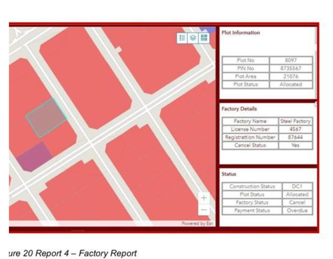

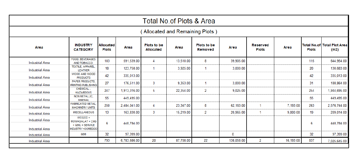

i would like to create custom reporting widget where user will select parcel on the map based upon we need to get the info from related layers and need to generate a pdf with parcel info and map. kindly suggest how to generate reports. below are the examples
example 1
example 2
