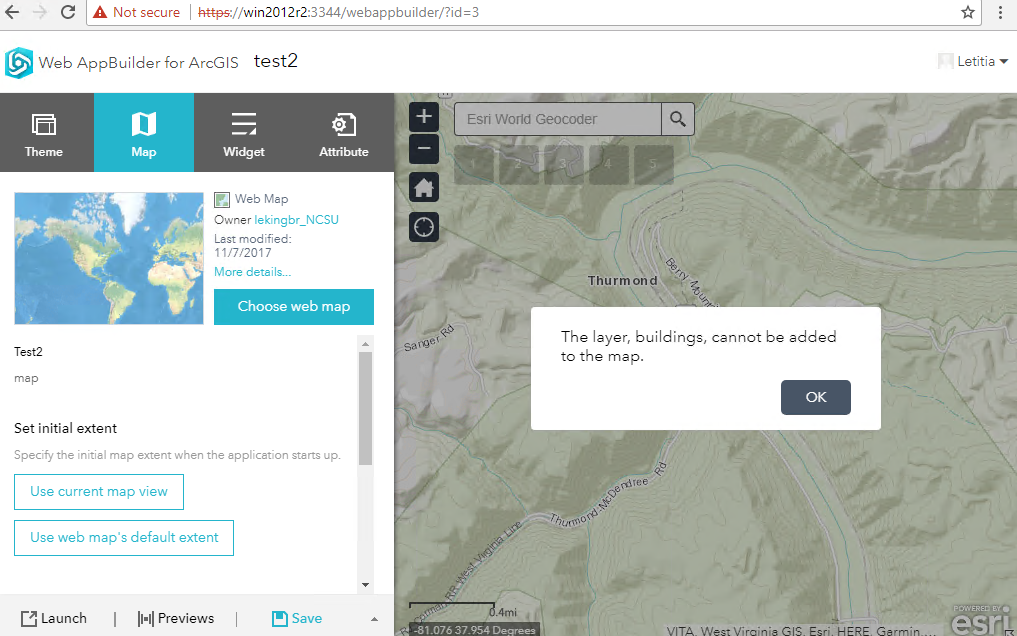

I've been having an issues with loading my layers in WebApp Developer Edition. When I load my map it states in can't load my layers.  I was trying to use the enhanced search widget but I think my first issue is the error I received when loading the map.

Letitia,
   How is the layer buildings being added to the map? Is is part of the webmap? Is the layer secured? Is the webmap shared publicly?

Robert  I just looked at the layer with ArcGIS Online Assistant  and the only difference in the one that works is the port number 6080 is in the layer; in class I have version 10.5.1 arcmap. I'm going to try it with my work desktop which is 10.3.1. I'm not sure how that port number is added to that service.   How is the layer buildings being added to the map? as a map service with only that building layer. Is is part of the webmap? yes.  Is the layer secured? no Is the webmap shared publicly? yes  That didn't work because work isn't public.

   The port number of :6080 at the end of the url means that you are not going through the Web Adaptor (which you really do not want to do).
