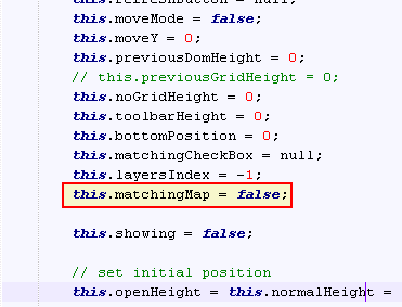

  • line 143: this.matchingCheckBox = null; should Not be changed.
  • line 145: this.matchingMap = false; should be changed to true

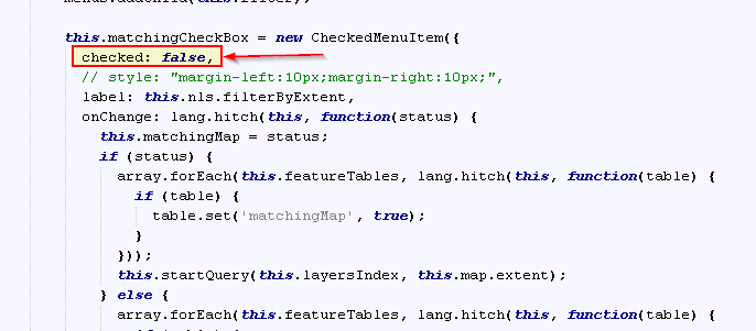

  • line 1031: checked: false, should be changed to true

Change code this.matchingMap = false;  TO this.matchingMap = True;  (ln 145 in version 1.2)
Change code checked: false,  TO checked: true, (ln 1031 in version 1.2)
