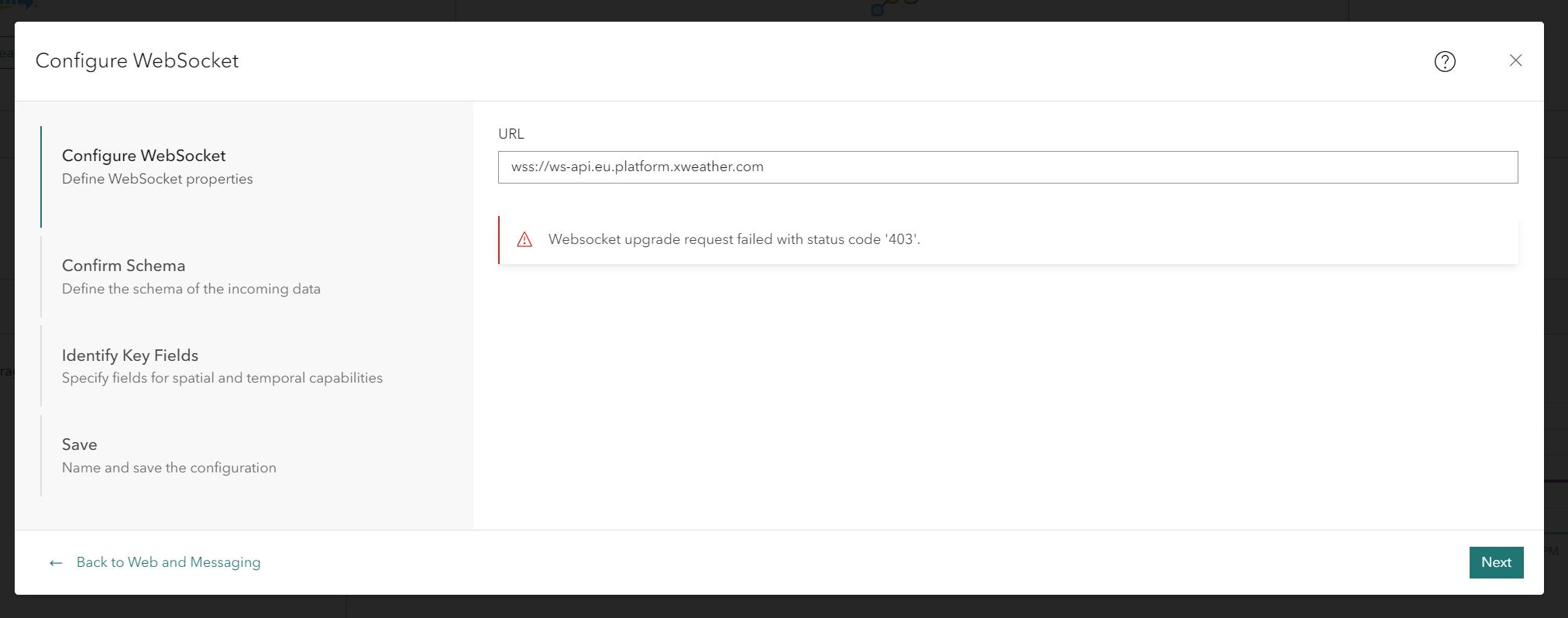

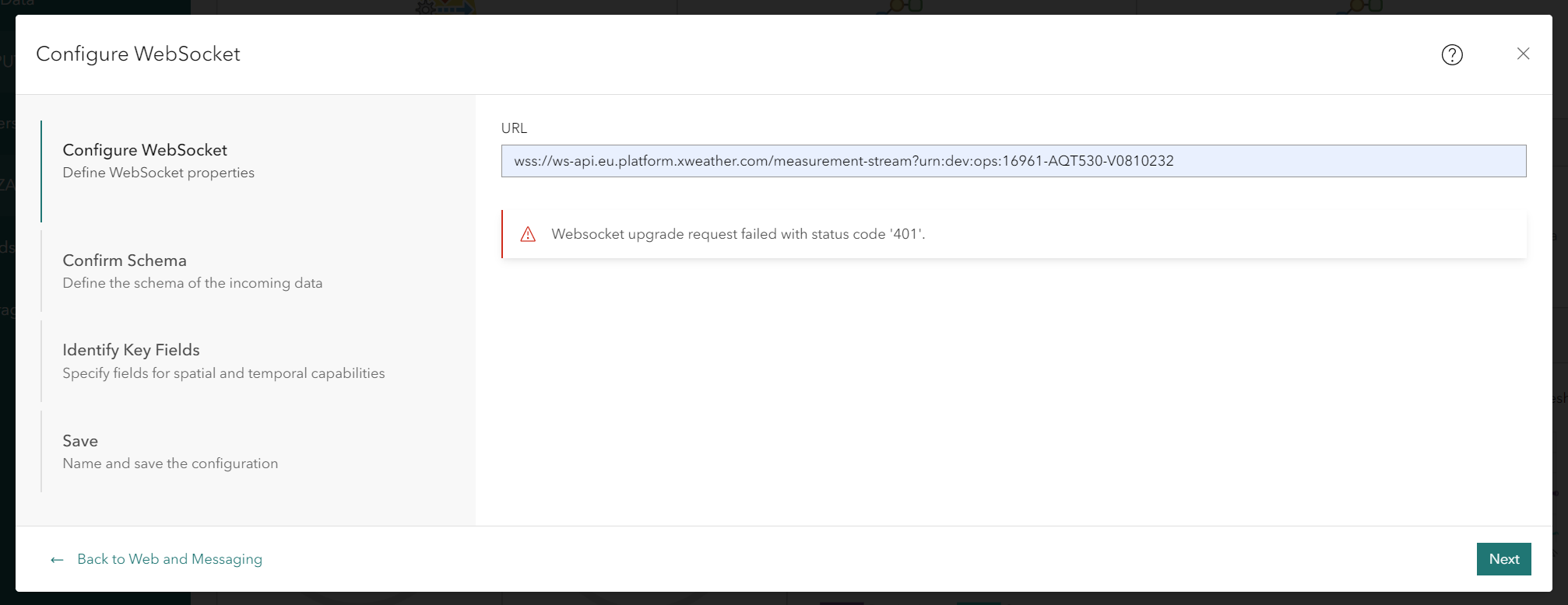

Trying to connect websocket in ArcGIS Velocity for Vaisala Air Quality sensors, hosted with XWeather. I'm getting an error in ArcGIS Velocity for the first step - just adding in the URI. I do need to incorporate the api key, so I'm wondering if I'm getting the error because there is not a place to add in an api-key header parameters on the first step?
The company confirmed websocket is external and has given me Python to try to make sure my API key is good, but I've never used Python so not really sure how to use that.  Ultimately, I really just want to connect to the sensor in ArcGIS Velocity and not worry about python!
Websocket: wss://ws-api.eu.platform.xweather.com
URI to call a specific sensor (I think?):
wss://ws-api.eu.platform.xweather.com/measurement-stream?sensor-id=urn:dev:ops:16961AQT530-V0810232
But gives error in ArcGIS Velocity. Would this be because the api-key is not in the URL? Is there a way to add this into the URL? Or should I be able to connect to the base uri without the parameters?

JeffSilberberg
Teresa,
     Just a guess here after taking a look at the Documention on Weather --
        https://docs.vaisala.com/r/M212980EN-B/en-US/GUID-64E9D6A5-0D6E-4A8A-B4E1-040E157A568D
 wss://ws-api.eu.platform.xweather.com/measurement-stream?sensor-id=urn:dev:ops:16961AQT530-V0810232&x-api_key="your_api_kery_here'
  Note the & after the sensor-id to separate the Key-Value Pairs.
Teresa_Blader
Shoot... I did try your suggestion and it still errors... I tried ? and &... Thanks for providing the link! Sounds like Peter and the team will explore header parameter options with my api key... so I'll see how that goes.

JeffSilberberg
Good Morning -- I talked with Viasla about this and got two interesting pieces of data.
First, "So, the key-value pair is x-api-key={'My-Api-Key'}."
Second, the documentation page I referenced is in review as it "needs updating".
Try this in Velocity --
wss://ws-api.eu.platform.xweather.com/measurement-stream?x-api-key='My-Api-Key'&sensor-id=urn:dev:ops:16961AQT530-V0810232
Teresa_Blader
Still a no go - Vaisala support is telling me api key HAS to be passed as a header parameter and can't be passed in the URL😢 Thanks for investigating!
Regarding the measurement stream api, the api key has to be passed in the headers. The link you shared won't work as the key is passed as a query parameter.
So, if it will be something like this in the system you are using:
URI field: wss://ws-api.eu.platform.xweather.com/measurement-stream?sensor-id=urn:dev:ops:16961AQT530-V0810232
headers field: "x-api_key": ”my-api-key-here”
