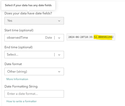

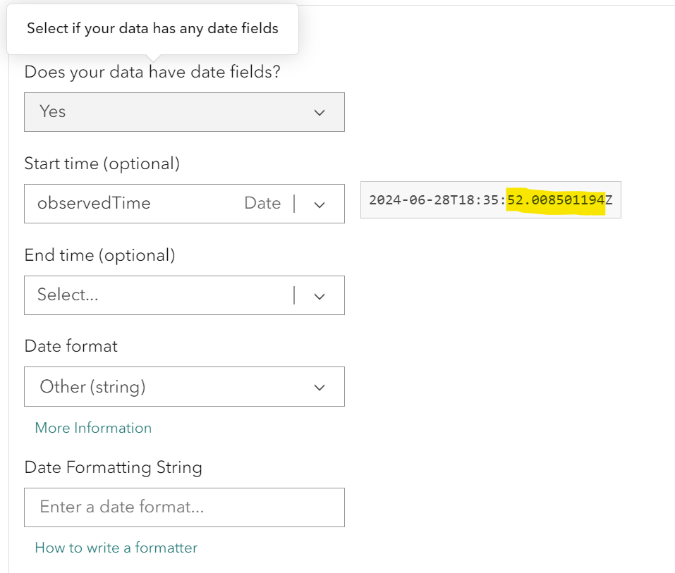

Sometimes a feed doesn't always follow the exact same time format for seconds and milliseconds and how many decimal points it has in a single date field. Velocity then seems to ignore the time stamp when it doesn't follow the specified formatting, leaving date field blank, unless it matches.
The first return row has a timestamp with 9 decimals however, not all of the data has 9 decimals, most don't have any decimals. Everything has seconds at least.
"2024-06-28T19:13:00Z"
"2024-06-28T19:05:52.502140873Z"
Is there something I am missing? Should I be using a specific notation when it's like this? The documentation provided didn't seem to discuss rogue timestamps. I wouldn't mind it rounding up to seconds, but I at least want it to pass through.

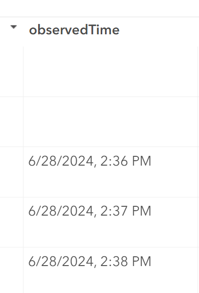

Two rows don't get a date.... the others do:

   I have found that doing this is a Field calculation within the analytic makes more sense and results in better consistency in data than doing it in the Feed.  You can do an Arcade function to make the correct decisions and build the date you want.
 In 5.1 Esri introduced a number of new Date functions and Types as well as synced Arcade and Velocity.   The new Date functions have helped a lot, I have yet to figure out how to use the new Date Types within Velocity.
PeterNasuti
@Teresa_Blader I agree with @JeffSilberberg's suggestion above. Using the Map Fields tool for a field calculation depending on string length (or just using the text slicing to grab the correct elements) would be a better solution and can assign the "Start Time" tag. This could be a combination of the IIf function, Date function, etc. to parse the date correctly
The Velocity feeds and sources "date format" is expecting a single consistent date format. The behavior you are seeing is as designed where if the string can't be parsed to the date format the value is nulled.

So..... I would then be setting up the feed to not have a start time? Isn't that kind of integral to the feed? Instead I'll just set the dates as a string, not date, and then add the date with the real-time analytic with map fields?

Yes, No Start Time.  Do that in the Field Mapper.
