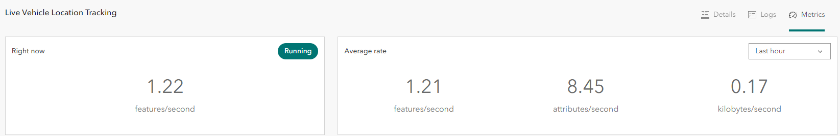

I have had a Feed running without any issues for months in Velocity, this feeds uses Azure Event Hub as an input and I can see that features are coming through just fine without any issues under the metrics. Event Hub also looks pretty healthy in Azure.

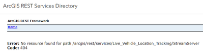

Since about 9 AM CST, I am seeing that the stream service in ArcGIS Online that's linked to this feed is down. The feature layer linked with this feed seems to be receiving partial data, but the actual stream in AGOL errors out.
Chrome developer tools show the below errors -
Any help or inputs will be appreciated.

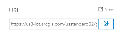

@MuneerMajid We were just reviewing this internally on the Velocity team. This was a software defect specific to feeds with spaces in the title. When these feeds are edited, there is a URL issue introduced (the spaces are originally replaced with underscores, however the issue is that this is changed when it should not be.
This bug will be resolved with the 5.2 release that will go live tomorrow evening 6/25/24. Unfortunately in the case of existing feeds, the feed will need to be recreated to revert to having a correct URL. The support analyst on your case will be reaching out with additional details.
