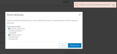

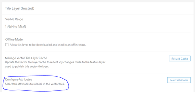

I did the process of creating a vector tile from  data in a oracle enterprise GDB and it is not possible to anable the pop-ups from the vector tile. However, I see an option in the portal item that I am not sure how it works
when I go to the option I see the layer's attributes , and when I select the attributes and try rebuild cache, the following error appears
Is not possible to have pop-ups from vector-tiles yet?
