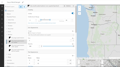

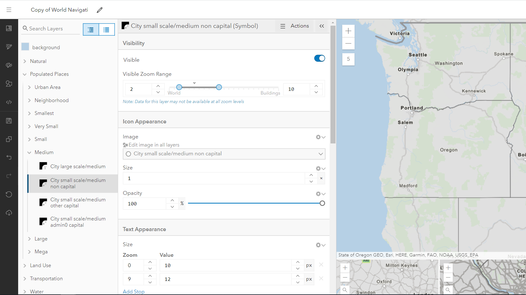

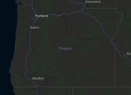

I've noticed with the majority of default Esri basemaps that the cities displayed in Oregon at small scales don't make sense from a city population size perspective. Medford is consistently shown even though Eugene and Bend both have larger populations.
I went into the vector tile editor to try to change this and am struggling to figure out how. From what I can tell the cities I want to be able to see are medium non-capital cities and should be showing at this scale based on the visibility range.
Does anyone have any suggestions of what I might be missing?
