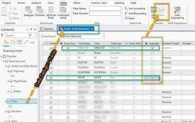

Apologies for any confusion, let me clarify. If we are following the "Simple Pop Ups" workflow, we will be required to check the "Highlighted" fields from the "fields view" then "Save".
With the map configured this way, both the resulting Vector tile layer (.vtpk) and/or Published Vector Tile Service Layers, will allow for the popups to be enabled in ArcGIS Pro.
We are still looking forward to the ability to do this in the web-based Map Viewers in the future.
