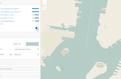

This small gap appears on all vector basemaps from Esri when the boundaries are taken off. This is the Hudson River between NYC and Jersey
Also, what is with the two colors of the water?
Esri, please fix. Its annoying that I need to photoshop this out everytime I export the map out.

In the Vector Tile Style Editor, you can actually see that the "two colors" is due to the Land/Not Ice layer showing trough the water layer, either because of transparency of layer blending. Not all basemap styles include this layer, and as with any layer in the vector style editor, you can remove/restyle it as needed.

The boundary gap should be resolved in our December release (~16th of the month).  Thanks for the comments.

This glitch still exists. The only current solution is to deactivate the land layer in ArcGIS VTSE, to download the custom basemap, and then to load a secondary basemap from ArcGIS Pro under the custom one, which "hides" the gaps. Not ideal.
