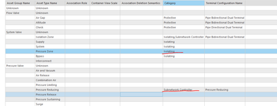

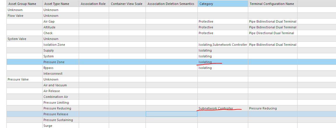

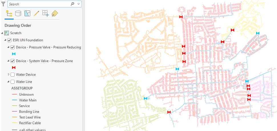

I have not yet deployed a UN to production environment. Currently working in test environment and trying to establish the subnetworks for our Water UN (Hierarchical tier). In many ways, the schema is very close to the ESRI Water UN Foundation database, which is what I'd like to point to for this question.
For creating subnetworks, I realize you must assign one or more subnetwork controllers as the point of entry, but what I'm not understanding with the ESRI UN foundation shown below is how System Valve / Pressure Zone features are the barrier points for defining a pressure plane subnetwork. In the network properties (2nd screenshot), it's Pressure Valve / Pressure Reducing features that are controllers. So where is it defined in the network to indicate that System Valve / Pressure Zone can also be a start/end subnetwork barrier? I don't think "Isolating" category is relevant for a pressure subnetwork. I don't see anything else, and cannot find any documentation, to know exactly how this works.

Features with that subnetwork categories are capable of being controllers, but to make them controllers you must use the Modify Subnetwork Controllers pane.
The barriers are defined in the subnetwork definition for that tier. Any feature that meets the condition barriers defined for that subnetwork will be treated as a barrier. In the water utility network foundation a pressure zone treats features that are closed or features that are proposed as barriers. A system valve between pressure zones is typically kept closed, meaning it will act as a barrier, but if you set the pressure zone system valve to be open it will no longer act as a barrier (which will likely result in inconsistent subnetwork names between the pressure zones on either side of it).

Right, I understood how to set subnetwork controllers and the general concept of barriers, but my problem was that I didn't know specifically where/how exactly it was defined and how it could be updated. I was expecting the barriers to be defined in the network properties with explicit references to System Valve / Pressure Zone (and maybe a few other asset group/type combos), whereas after reading more documentation and digging around I now realize the P: Device Status attribute ("presentstatus" field) being set to "Closed" is how the pressure subnetwork's configuration is defined. Maybe these things are obvious if you already know every in and out of a UN, but it took some piecing together for me. It's so easy to forget such details if you took a training course 6 months ago and are just now focused on this part of UN design.
I removed the normal and present status fields, so I guess those should be added back into my UN. At least present status. Is there an alternative way to define the barriers that might make things simpler if we don't want to track current valve status of open/closed?
