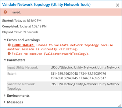

Hi,
I'm seemingly and recently getting overwhelmed with a validation issue that reports as "Error: Unable to validate … because another session is validating". This happens after validation times out. Restarting ArcGIS Pro and/or the Service does not seem to change it. As if there is a cached session ...
Disabling/Enabling Topology works ok, however, validation itself is timing out. I've reconfigured the time out parameters for the un service with no change. The ArcGIS Server is not reporting any issues ... In the logs, however, there is the following line mentioned (quite a few times):
"com.esri.arcgis.discovery.json.JSONException: Expected a ':' after a key at character 38 of {guid}" The GUID does not seem to correspond to any feature. Could it be a red herring?
I'm validating at current extent on SDE.DEFAULT with a scale of 1:20. The un itself is close to 1mil features, with appr. 8k of errors. I need validation to work to resolve them
Is there a way to clear these validation sessions? Some seem to hang around for hours ... ( ... requestID="">guid is 173 minutes old)
Any help is appreciated!

The utility network allows only one session to be validating on DEFAULT at a time. When performing a validate topology on the DEFAULT version the validate operation acquires a lock and starts working, any other validate attempts will fail with the error you outlined above if a validate session already running.
At 1:20 scale the validate process should quickly finish, so something isn't right. We would like to know more details, here are few questions
1. What version of ArcGIS Server/Pro are you running?
2. How many features (roughly in the 1:20 scale)?
3. How many dirty areas in the 1:20 scale?
4. How many total error features you have in the utility network (you can find that out in network properties)
Meanwhile for a workaround you can simply stop the validate process to release the serialized lock. That can be done by either restarting the feature service or setting a lower usage timeout on arcgis server for that particular feature service (Default is 10 minutes I think)

jhd011
Hey Hussein,
Thank you for your quick reply! To answer your questions:
1. What version of ArcGIS Server/Pro are you running? 10.7.1 w/ Pro 2.4.2 (UN Release 3)
Most of the time, I'm resolving stacked points:
2. How many features (roughly in the 1:20 scale)? 18
3. How many dirty areas in the 1:20 scale? 56 (29 Point Errors, 27 Line Errors)
  • As a clarification note, the same occurs with 3 features / 3 dirty areas @ 1:5 scale.
4. How many total error features you have in the utility network (you can find that out in network properties) 8,162 (less than 1% of total non-error features)
In this particular scenario, I only have to delete one point (the stacked junction) and it will resolve all 56 errors.
Thank you for your help!

jhd011
Hey Hussein,
I have figured out the issue, and it is not what I expected.
You see, I'm working with two maps (locked vertically). One (right) contains a non-un service, and the other (left) has my un service. I use the non-un service as a migration comparison. Both services are hosted on the same server/portal but in different server directories. Same portal user.
When I have both maps open side-by-side in Pro, validation times out. When I only have the UN map open, validation completes in 2-4 seconds on default.
Kind of unexpected ...
