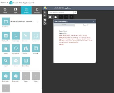

Hi,
Is there a way to run the Validate Network Topology tool as web tools? I published this tool on the portal with the "share as a web tools" method. But I am getting an error while running the tool.

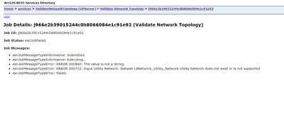

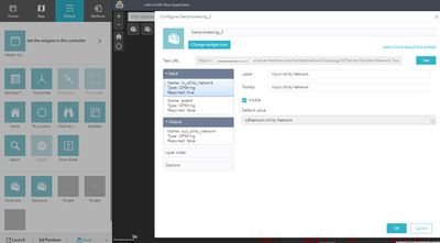

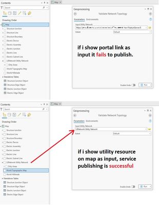

Yes i actually had some trouble publishing the tool. But when I add the utility source from the map, I can publish the service successfully.
There is a situation as I mentioned in the screenshot. The service is running successfully, but the tool errors while running.
