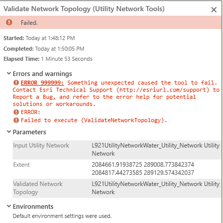

When validating my network topology on dirty areas it fails with a very generic error message.  I tried it through the GP tool and get
and if I just try it the data tab across the top of Pro I get either one of these.
I just created this Utility network and getting this from the begining.  I am getting this message in default and in child version.  I'm running Pro 2.6.3 and Server 10.8.1

@LindseyStone - You should not be getting a generic validate failed error message like this.
I would recommend contacting support services to see if they can help isolate the issue further and either log a new data specific bug or link you to an existing issue.

At first it was validating some times, but once it started to error it would error every time.  The only way to get the error to stop is to disable topology and then enable topology.  But it is very short lived before it starts again.  I have ran the GP tool, the validate in the ribbon, and opened up a completely blank project.
I did finally find this bug that is pretty much spot on. Bug BUG-000133185
