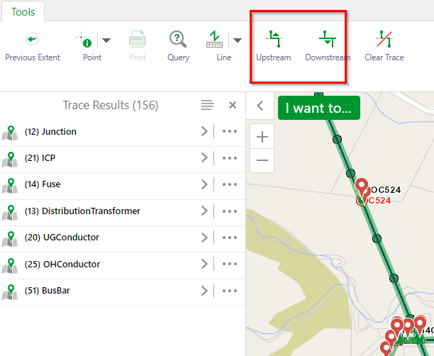

Hey guys,  we soon would need to publish our UN Network to our geocortex viewers, and one question comes to my mind.
How do I trace?
We have ArcFM Web and Geocortex, currently, we're using the old geometric network published with ArcFM enabled for tracing, but soon we'll stop the sync between UN and GN therefore I'd need to replace the tracing functionality from the old environment and use the UN fully.
(screenshot is taken from 10.8.1, ArcFM Web 4.11)
Anyone has got a clue on how I would trace using the upstream/downstream buttons?
VickyWang
Hi @ManueleMesseri
Not sure about the Upstream/Downstream button via ArcFM Web 4.11. You could create workflows for the trace function using the Utility Network ArcGIS REST API. Pass the trace parameters: trace location, barriers etc; then get back the trace result.
https://developers.arcgis.com/rest/services-reference/trace-utility-network-server-.htm
~Vicky Wang~
