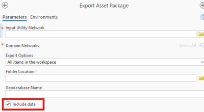

Just make sure to select the "include data" option when exporting the asset package.

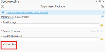

Load Data when applying the asset package.
