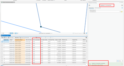

MatheusSparapani
I have the same problem with the "Update is Connected", this tool don't update my WaterLine, so, i can't create de SubnetWork for all my line, Some Can I Help me?
