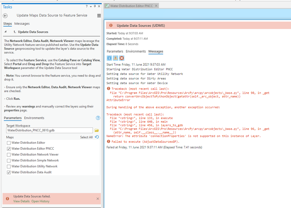

Hello, we came across this error when using the task come with UN water solution. Right now we are using file geodatabase. Wondering what's the problem here?

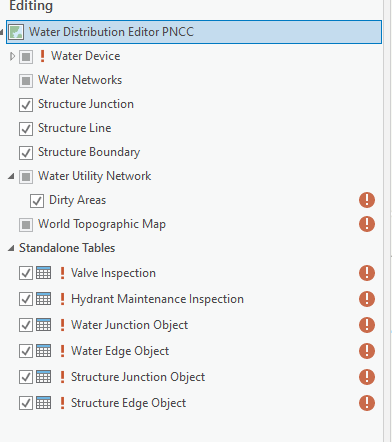

Can you post a picture of the layers in your TOC?  I uploaded a newer version of the tool that might solve your issue.

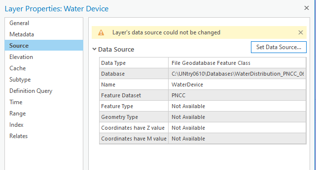

Song_Li
I can change the data source one by one. But I found that sometimes I can change the data source for one layer and the others automatically follow. sometimes it doesn't allow me to change the source of dataCapture1.PNG
Song_Li
I deleted the map and recreated a copy. now when I change the data source for water device layer, all other items are automatically switched to new data source. Thanks for the updated tool. will save it for future use. Cheers,
