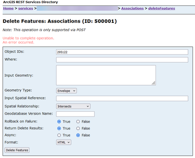

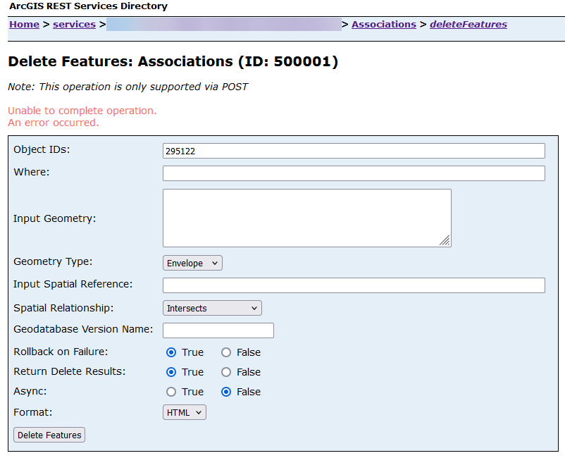

2- I can't find how to get the Asso layer from the Version object... Listing all version.layers layers does not return the 500001 layer...
3- trying this
featureLayer.delete_features(deletes=oids, gdb_version=gdb_version, rollback_on_failure=True)
results in the error :
ERROR: 2024-11-07 10:53:05,333 - ERROR - Error: Unable to complete operation.
Unable to perform applyEdits operation.
An error occurred.
(Error Code: 500)

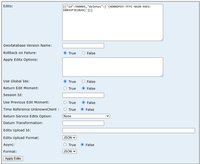

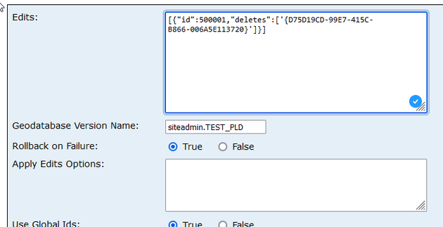

Finally, when applying edits directly on the service, it results in a success... but it seems to have no effect because I can still find the globalId in the same version after the applyEdit...
  "id": 500001,
  "deleteResults": [
    "globalId": "{D75D19CD-99E7-415C-B866-006A5E113720}",
    "success": true

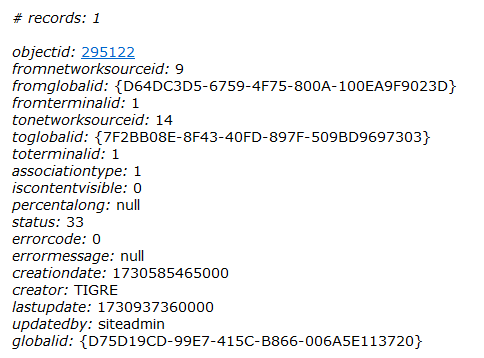

[EDIT] : it IS working when deleting from the service, in Default or Named versions. However, I can still query the feature, but the Status field changed from 0 to 33, probably indicating that the row has been deleted.
[EDIT 2] Reading the doc (https://pro.arcgis.com/en/pro-app/latest/help/data/utility-network/associations-table.htm#GUID-DF91C...) I am not sure how to interpret the 33 Status value...
CEO of MAGIS
RobertKrisher
@PierreloupDucroix  Deleting an association, through rest or the user interface, only logically deletes the association. Once you validate the edit, updating the system tables, the association will be physically deleted from the version. 33 = 32 + 1 = The "To feature" in the association is dirty and the association is deleted. This means when the association was logically deleted we placed a dirty area on the "to object" so it could be validated using the map.
