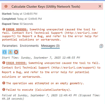

Hello @RobertKrisher and all,
We encountered an error while running the Calculate Cluster Key tool: "Operation was attempted on empty geometry." In our case, the UNM implementation was utilising a custom coordinate system.
We then tested the tool on Water Distribution UN Foundation gdb, which uses Esri coordinate system (NAD 1983 StatePlane Illinois East FIPS 1201, US Feet), and the tool functioned as expected. However, after we changed the spatial reference of the Water Distribution UN Foundation gdb to the same custom coordinate system, it hit the same error.
Was wondering if this tool does not support the UNM implementation in custom coordinate system or if there is something i missed?

@AmberY also, can you please provide repro steps (and ideally log a case with support) that shows how you're getting a 999999 error when enabling cluster keys? You shouldn't be getting an error.
