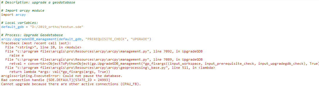

Hi All,
Can anyone suggest how this issue can be sorted out? We are trying to do staging in sde environment.
Regards,
Srinivas
Tags (1)
MikeMillerGIS
Esri Frequent Contributor
Have you run the upgrade geodatabase geoprocessing tool?
https://pro.arcgis.com/en/pro-app/tool-reference/data-management/upgrade-geodatabase.htm
SrinivasaRao1
Thanks for sending the link, when performing an operation using the python script, the below error shown.
PaulLeBlanc1
Upgrade Geodatabase (Data Management)—ArcGIS Pro | Documentation
For enterprise geodatabases, it determines if the following criteria are met:
  • The connected user has the appropriate privileges to upgrade the geodatabase.
  • The connected user is not editing data in the geodatabase.
  • No other users are connected to the geodatabase.
You can remove connections from Pro or programmatically with DisconnectUser—ArcGIS Pro | Documentation
