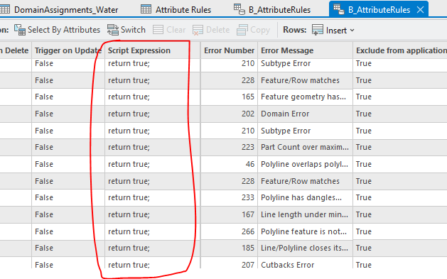

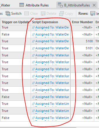

All of the Essential version's attribute rules have Script Expression = “return true;”, not a true script doing anything. This must surely be a mistake, right? I say this because the “Expanded” version of Water UN Foundation v2.1 has full Python scripts like you'd expect. Also, the Essential version has 66 attribute rules, while Expanded offers 23 rules. It seems like you’d have the exact opposite, proportionally speaking. So I’m not sure what’s correct and offered as intended with the 2.1 Water UN Foundation.
Essential version
Expanded version

The attribute rules included with each model are different. The attribute rules that are included with the essentials model are actually data reviewer rules to help you with assessing your data when you migrate. The attribute rules in the expanded are calculation and constraint rules to help you auto-populate attributes like asset id, symbol rotation, etc and constrain input values.
The expanded model only contains the calculation and constraint rules, and the essentials model only contains the data reviewer rules (validation attribute rules).
The essentials model is "essential" components only. Since auto population of attributes such as asset id, symbol rotation, etc are not what would be considered essential, they are not included with that model. If you need to implement those sort of attribute rules, Pro 3.4 has introduced templated attribute rules, which will help you in setting the most common ones.
