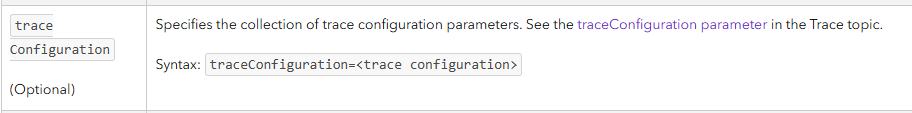

I reckon the ideal solution here is to use the EXPORT SUBNEWORK REST API.
The rest API call allows you to define a trace configuration where you can use one that is set only to output a certain type of barrier (use the config at the start of this answer)
https://developers.arcgis.com/rest/services-reference/enterprise/exportsubnetwork-utility-network-se...

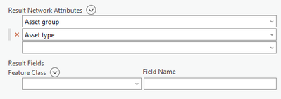

I can also see in the export subnet tool, that there is a "Result Network attribute" parameter that may help identify features that are "out of service" in post process, unfortunately there is no "Result network category" option to identify specific categories such as "ground" or others.

You are right, there is no "Result network category" but you could add the Asset Group and Asset Type to Result attributes and use those to identify the features that would make up "Ground" network category.

In fact, asset group and asset type seem to be a base result for features in the json :
      "networkSourceId" : 9,
      "globalId" : "{D14E41F9-3B84-4993-BF25-B3BA5F4ADB12}",
      "objectId" : 44156,
      "terminalId" : 1,
      "assetGroupCode" : 14,
      "assetTypeCode" : 14,
      "networkAttributeValues" : [
          "E:Cycle de vie" : 2
I will have to rework the CIM exporter in order to take this into account

Perfect! You can also use the "Include domain descriptions" options if that makes things easier.
