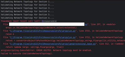

Recently we encountered "Error 001793: Network topology must be enabled" when trying to execute Validate Network Topology through the script.

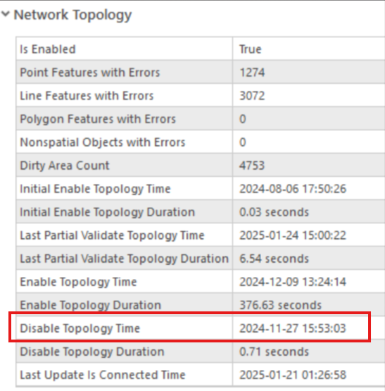

However, network topology is already enabled and has been for months per the Network Properties window in Pro:

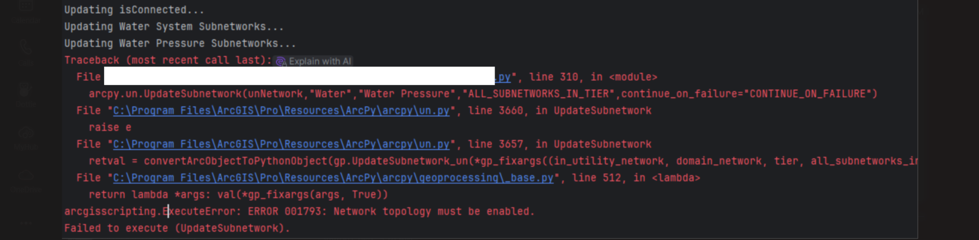

We hopped into Pro and successfully ran VNT on the full extent with the ribbon tool. Hopping back to the Python script, we successfully ran Update isConnected, but it errored out again on Update Subnetworks with the same "Network topology must be enabled" error.

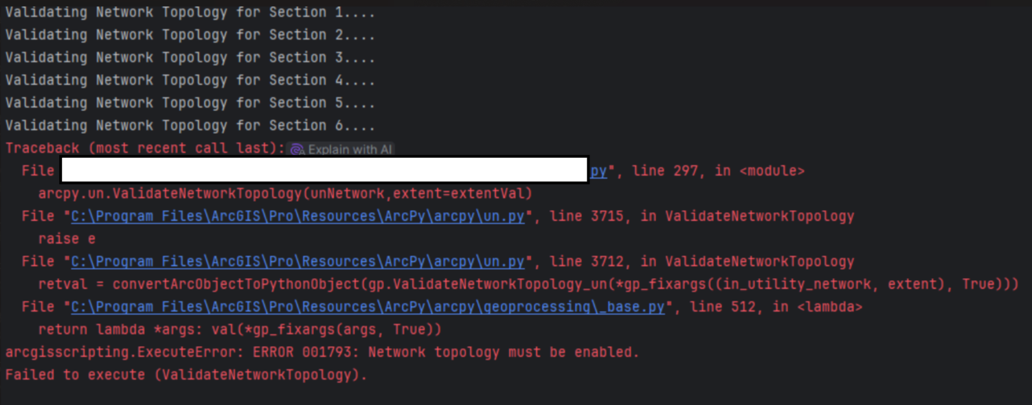

In the first screenshot I can see it's reaching section 6 before the error. Does that mean Sections 1 to 5 ran fine?
It's hard to tell what might be causing it.
