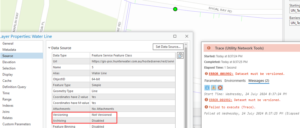

After some further testing, I believe this may be a bug in Pro.

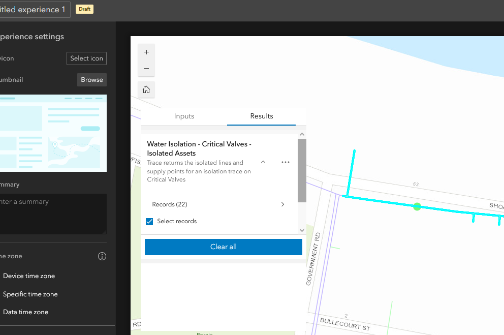

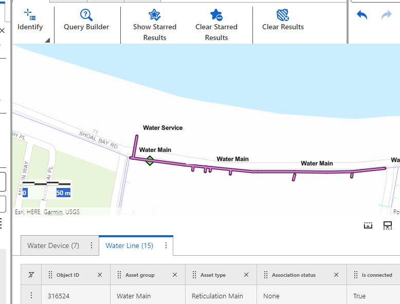

I was able to successfully trace this service in both VertiGIS Networks (V1.5) & Experience Builder (v1.14).
The error in pro (Dataset must be versioned) looks like it could be related to something interfering with the correct Data Source properties of the UN layers when the version management capability is not included with the published service. Below is a screenshot of the service in Pro, it reads as Not Versioned & Archiving not enabled, even though both are enabled (necessarily) on the Feature Class in the EGDB. The other 2 screenshots are from VertiGIS & EB showing a successful trace.
