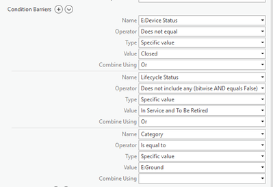

Can you post a screenshot of your condition barriers on the subnetwork definition?  We need to see why an open devices is not being honored.  You will need the lines on switch on different terminals, so the switch can barrier the subnetwork.  If the lines are on the same terminal, the switch will not break the load.
LindseyStone
Here is my condition barriers.  I didn't modify this in anyway from the downloaded version.  As I said if they are an OPEN phase disconnect through a switch or fuse it seems to be working.  It is only if it is a OPEN Load Break Switch.

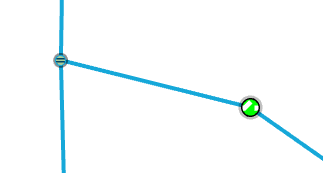

This is how I have it drawn in, with two MV Overhead Conductors connected to the open switch.
