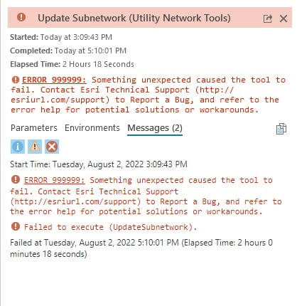

When I run the Update subnetwork tool I get the following error.
The tool gives an error after running for 2 hours continuously. When I look at the Subnetline layer, I saw that it creates 1500 features. But there are about 6500 more features to create, but the tool is breaking. When I run the tool after giving an error, I get the same error after 2 hours again.  I've run the Subnetwork Update tool 5-6 times, and I got the same error after 2 hours in all of them.

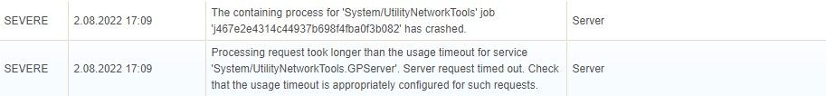

When I look at the Arcgis Server logs, I see this error first. "The containing process for System/UtilityNetworkTools' job 'j467e2e4314c44937b698f4fba0f3b082' has crashed."
I am also seeing this error afterwards.
"Processing request took longer than the usage timeout for service 'System/UtilityNetworkTools.GPServer'. Server request timed out. Check that the usage timeout is appropriately configured for such requests."

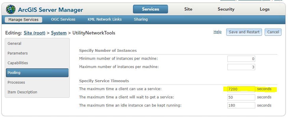

Hello @GIS_Solutions
The same issue which I have faced. Can you please try to change the duration of the timeout from below screenshot.
GIS_Solutions
this worked 👍
