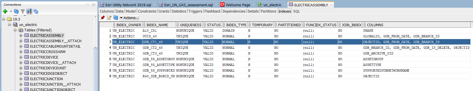

I have checked indexes in Oracle. Below screenshot shows the list of indexes for ELECTRICASSEMBLY table. Note that GDB_CT1_48 index references OBJECTID, GDB_FROM_DATE, GDB_BRANCH_ID columns. I suspect OBJECTID may be causing the issue. Note that ELECTRICDEVICE table also has a unique index set for OBJECTID.

The "Register as Versioned"  function failed the first time I tried it to run on  UN Electric, right after I applied the COTS Asset Package (Electric v3.4). As you suggested, I run UnregisterAsVersioned_management (see the log below). Then run "Register as Versioned" again to create BRANCH versions for the UN feature set. It failed with the exact same message: Unique indexes can't be specified for multiversion tables [Unique index GDB_CT1_48 found while enabling multibranch for UN_ELECTRIC.ELECTRICASSEMBLY] [UN_ELECTRIC.ElectricAssembly] Failed to execute (RegisterAsVersioned).

Upon further investigation the issue was triggered by settings of the default SDE_TBS tablespace. The "autoextensible" parameter was set to NO. The allocated by default 400Mb was just enough to complete Apply Package process but Oracle couldn't increment during execution of the "Register As Versioned", hence it failed. Troubleshooting was complicated by another defect I mentioned above:  Note the resulting dialog was shown as "empty white".  see screenshot below
As Paul LeBlank mentioned the reported messages were just the result of failed initial Register As Versioned attempt. I had to remove the user in   Oracle and alter the default SDE_TBS tablespace with autoextend ON:
alter database datafile 'C:\TEMP\ORA\DATABASE\SDE_TBS' autoextend on;
