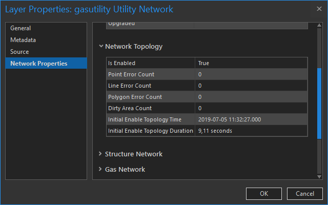

Staging and deploying a Utility Network works fine but it starts after running the Enable Network Topology tool (both Gas and Electric have the same issues since then). The tool itself succeeds but every other UN tool ran hereafter fails with the error:
ERROR 001793: Network topology must be enabled.
The network topology however, is enabled and trying to run Enable Network Topology again results in:
ERROR 001803: The network topology already exists.
Even the Utility Network's properties show that it is enabled:
This contradicting error proves to be quite the hassle, but there is more!
The Validate Topology and Trace tools fail with ERROR 001793 when ran from the Geoprocessing tab, but they succeed when ran from the ribbon. Since the ribbon doesn't contain all tools, we're still unable to run e.g. Update Subnetwork or Create Diagram.
