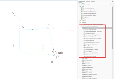

Hello, is it possible to publish the feature dataset from my asset package to AGOL for use in field maps? I am just trying to digitize geometry when out in the field as I am not complete or have staged/deployed a UN from the Asset Package and moved it to Enterprise. Just currently working in a FileGDB.

@Joshua_Moreno - Yes you can if you have network data in Asset Package.
You won't need to publish the whole package, you can just publish the Utility Network Tables
These should have the domains etc that will make online editing slightly easier.
You should also be able to create templates and forms etc for easier editing in FieldMaps.
You can also symbolize them the way you see fit.
What this will NOT have are the network rules, tracing, validation, etc. So this can lead to erroneous data being input which will only be caught when you stage the UN and turn on the topology.
