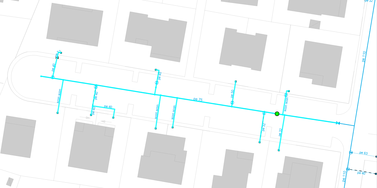

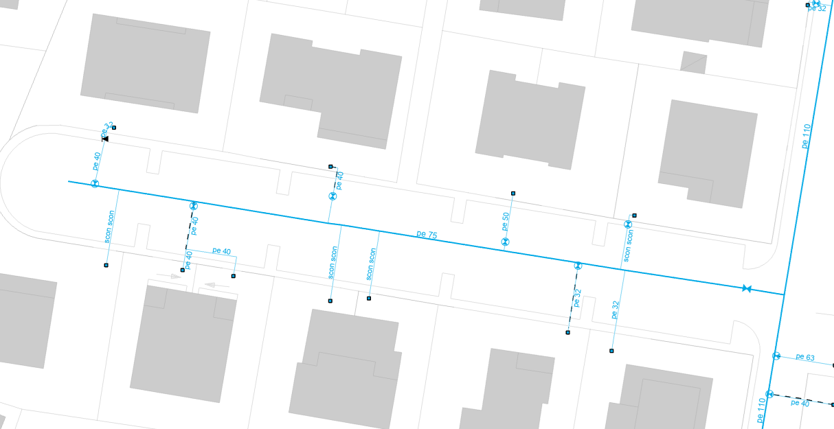

So, if I need to isolate this area, I have to close the valve on the right.
If I place the starting point on the left of at least a service line, the results of the trace are as expected:

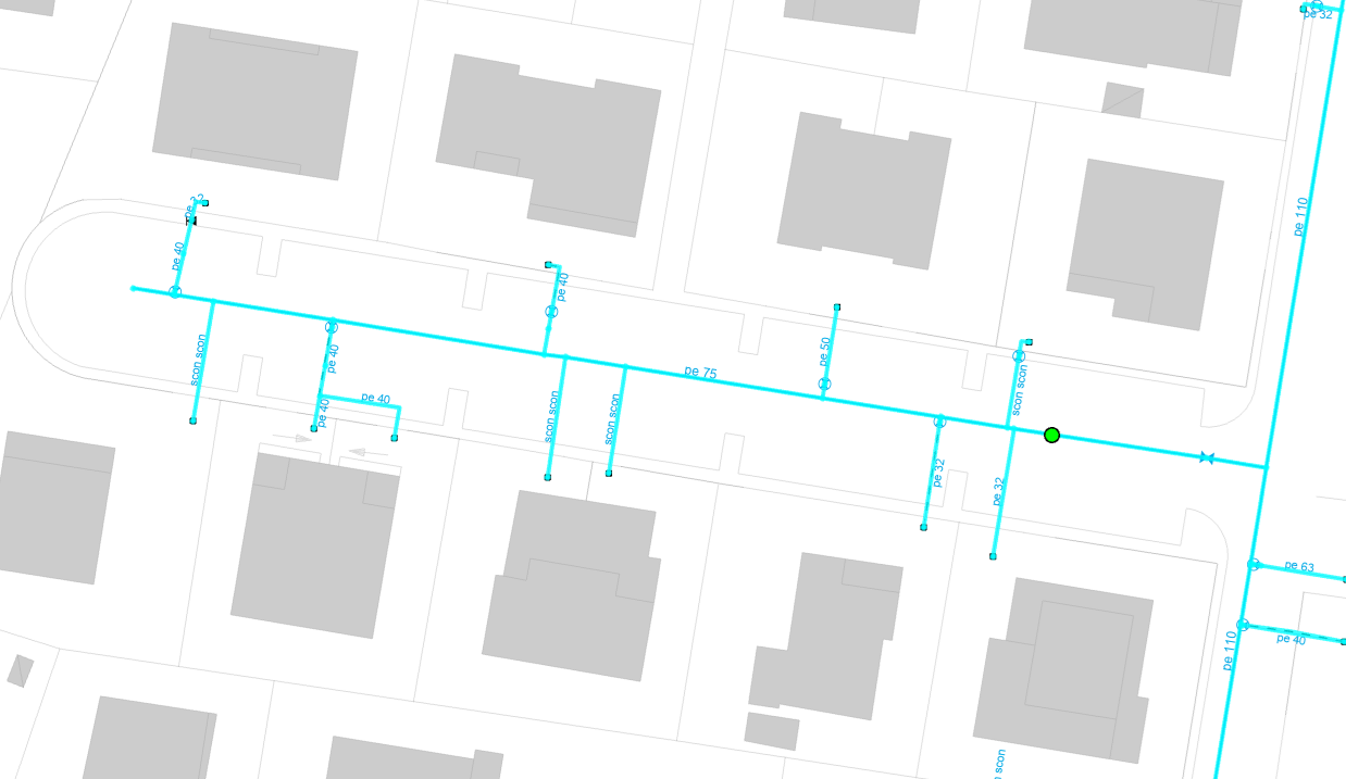

But if I place it on the right of the service lines, the valve is ignored:
The horizontal line is a single feature from the left tip to the valve, so I can't explain how having a junction between the starting point and the isolating barrier changes the results.
