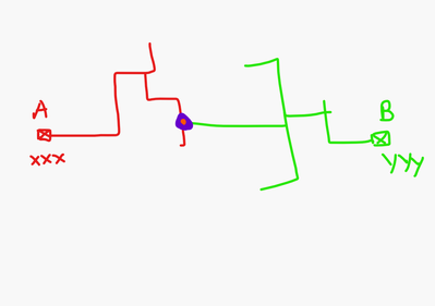

At face value the error is because there are 2 separate subnetworks that are merging into one another. The system expects an isolating feature where two subnetworks meet. For example two separate subnetworks xyz and YYY are merging without an isolation device separating them.
Some of the common failures in this situation are when both lines are connected to the same terminal of the isolating device.

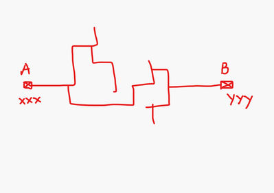

Another cause is when two subnetwork controllers feeding the subnetwork have different subnetwork names. For example below is subnetwork that is fed by 2 controllers A and B but if they are setup with different subnetwork names then that will lead to an error.
As for fault finding, after you update the subnetwork and it fails it should create a subnetwork error around all the subnetwork controller that are contributing to the issue. This might help you isolate the problematic ones.

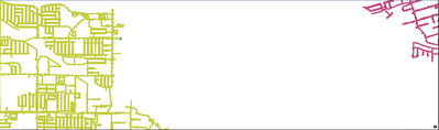

EDIT - Also the test for doing a connected trace with just subnetwork controllers as filter barrier will most likely result in selection of the entire network because the connected trace will "pass through" open/isolating devices. From the screenshot yours looks like a meshed network so it is expected that the trace will find a way to all the features.
If you want to use connected trace + barrier features then use more than just the subnetwork controller condition. Maybe add open devices, lifecycle status etc.
