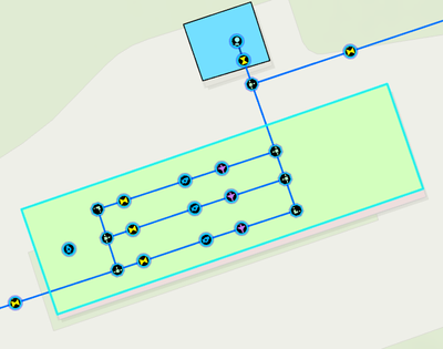

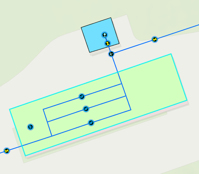

For example, lets look at a Pump Stations.  In this example, we are modeling three pumps.
If we turn on Show Content, we can see that fitting and the valves turn on.
So we are essentially modeling "Assemblies", but using the structure boundary instead of a domain Assembly feature.
