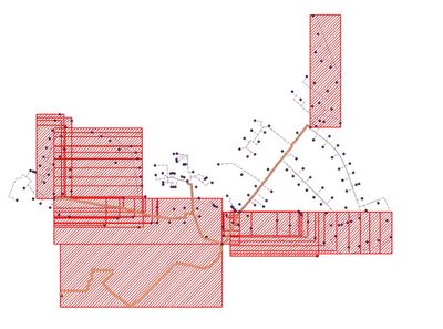

my friend and I defined our first network rules today by using the rule types:
  1. junction junction connectivity
  2. junction edge connectivity
After reactivating the network topology we stumbled upon a lot of errors. We were able to fix a lot of them but couldn't solve errors with statuses 21 and 25.
Error code 21 means:
"Duplicate vertices. A linear network feature has vertices existing in the same x,y, and z locations. For example, a gravity pipe has missing z-values. This could also be encountered in cases in which a line has fewer than two vertices or in which a line feature has a length within the tolerance."
Error code 25 means:
"Stacked point features. Two or more points are geometrically coincident. For example, a service point and a voltage regulator have the same x,y, and z coordinates. Some features cannot exist in the same location, while others can."
We have stacked point features but thought we will need them later since these locations define the position of a distribution box and also deliver the information on how the cables from the main cable network will be split in the distribution cable network.
The error 21 we don't understand at all. Maybe someone can give us further details.
Thankyou in advance and Greetings from Germany, Fynn and Luca

Mikes 2nd suggestion for the stacked points worked out perfectly. Thats solved but suggestion 1 for the vertices brought up even more errors. Error 21 is still existent and in addition, I got a bunch of error 10s: Invalid connectivity - The edges are different subtypes and cannot connect. So I checked the error description.
It's true both are different subtypes but are properly classified and have a point in between. Moreover, the point has two junction edge rules one for each individual line. It doesnt make sense to me.

Fixing the stacked points probably caused the Error 10s.  Make sure the point at the same XYZ as the line has a rule.  Check to see if that point is a device and has terminal configurations
FynnScharpen
You are right! I solved that. Back to 51 errors only duplicate vertices. Any other suggestions?
FynnScharpen
I also used check geometry for the cables and the table which is listing all problems is empty.
