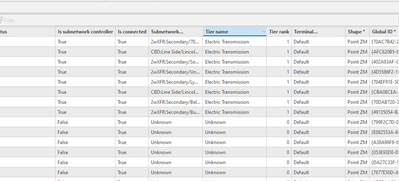

1. How can we update the tier name and tier rank of devices? They are in a subnetwork (subnetwork name filled) which is part of a tier but the tier name and tier rank remain "Unknown".

These are system managed fields and are only populated for subnetwork controllers:
