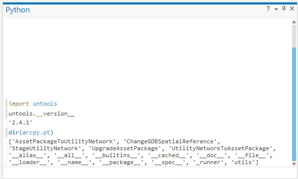

PaulLeBlanc1
If you run the following from the python window in Pro, what does it show?
import untools
untools.__version__
dir(arcpy.pt)
If StageUtilityNetwork shows up here, that means it is installed but is hidden from the UI. Not sure what could cause only this tool to do this...

IvoIhtimanski
Thank you Paul! The mistake was mine I didn't choose a clone version in Project Environment.
