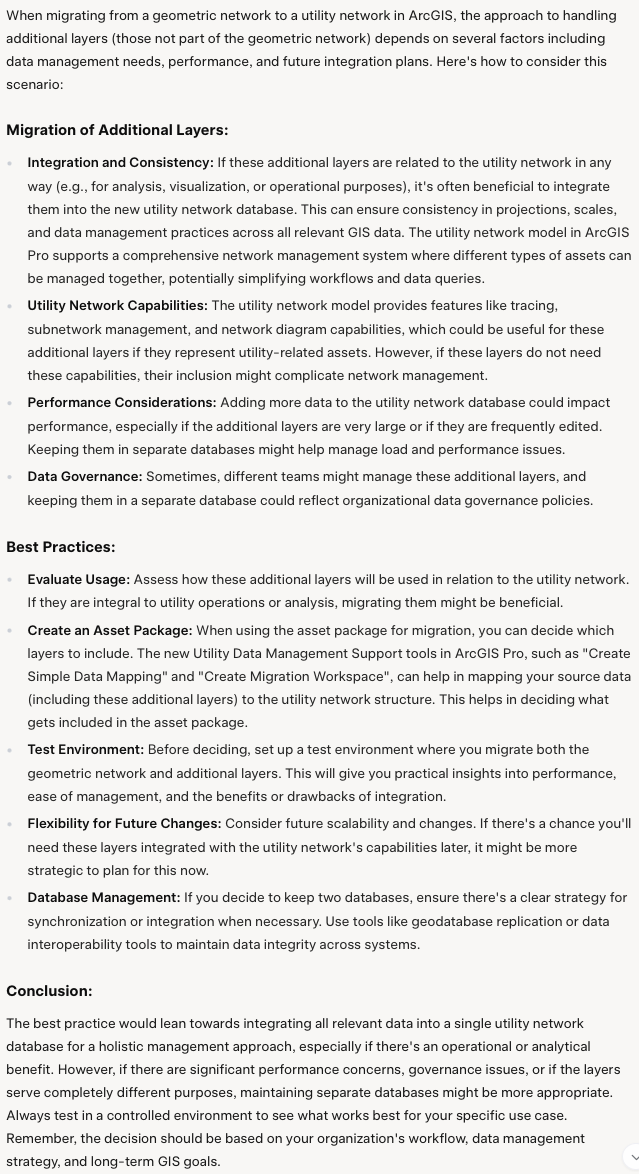

I've attached a document with some advice, do you agree or disagree?
We are a small Gas Distribution Company and our entire Asset package we are importing is only 450MB so performance likely will not be an issue.
