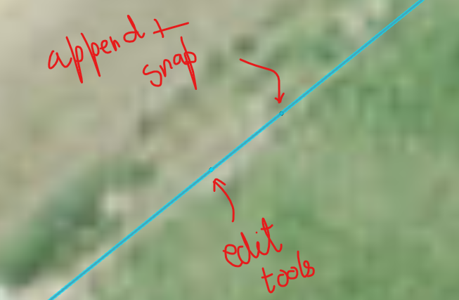

We want to add a bunch of attachments (Electric Junctions). These were created outside the UN.
We have explored the append tool and as noted in a few other posts, it doesn't trigger an "edit" on the line it's placed on.
Another tool that was mentioned was "Integrate", which changes the geometry of the lines. Undesirable.
How would one go about adding data to the UN and ensure it's maintaining the topology?
Adding a Electric Junction via the Edit Tools creates a dirty area around the point feature and the line it's placed on.
This is not observed when you add using append and even after snapping the point the line.
This means they are not actually connected.
This is proved by tracing the circuit, the attachment added using edit tools is selected while the other one is not.
