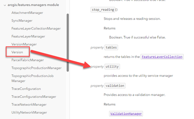

It seems a little like cheating, but my preferred way to get a UN pointed as a specific version is to get it from the version itself. there is a "utility" property on each version that contains a reference to the utility network for that version (if one is present in the service).
