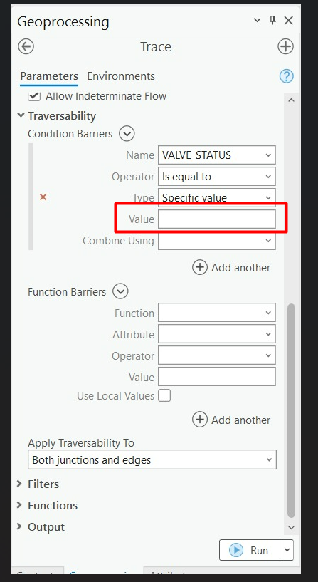

Hi everyone, we try to run isolation tracing, however when to choose the value, the code domain not available as shown below, i need to key in the code.

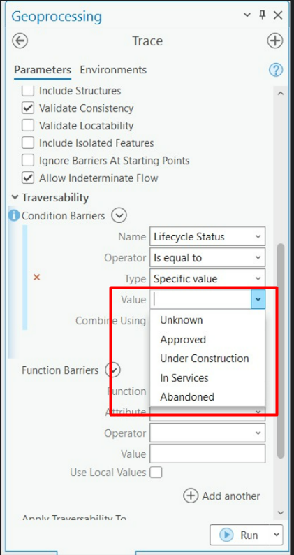

But, for  lifecycle status, the domain shown

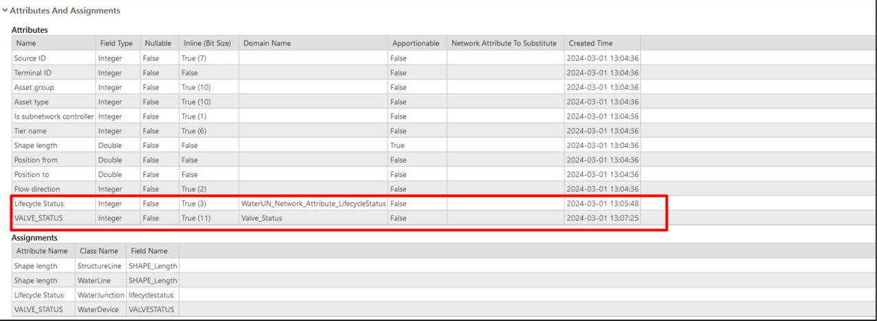

 we already set the domain when create the network attribute
What should we do..

Sadly, it does not use the domain of the inline network attribute.  It uses the domain assigned at the field of the first class that NA is assigned to.
RobertKrisher
@NadiaAlami Make sure that your device class has the correct domain assigned to it at the object class level (for this UI), and that each subtype/asset group that corresponds to an operable device has this domain assigned at the subtype level (for the attribute editor).
