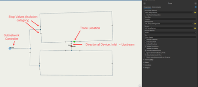

Hi all,
We've run into some strange results when performing isolation traces.
A bit about our UN:
  • Water Utility (Hierarchical/Mesh/Source)
  • UN 5, Pro 2.9.10, Enterprise 10.9.1 (latest patches)

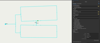

The issue seems to trigger when a directional device within a loop is isolated by an Isolation trace. It looks like the system correctly recognises that the upstream of a device is without flow and therefore should extend the isolation downstream of that device. Now because the downstream has another path back to the controller, the isolation is reaching the controller and then taking out the entire supply zone (at least that's how I'm interpreting this result)
In reality, because the downstream side has another path back to the controller, flow should actually be able to reach the southern loop even with the isolation in place to the north.
Things I've tried so far:
  • Removing the directional device (Gives correct result)
  • Making the directional device a controller (not a good solution and didn't work anyway)
  • Deploying into enterprise 11.1 with a version 6 UN (Same issue)
SamDeLore_0-1697694660861.pngSamDeLore_0-1697694660861.pngSamDeLore_1-1697694668772.pngSamDeLore_1-1697694668772.png

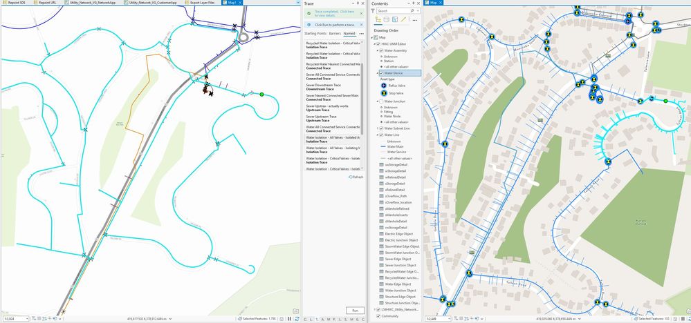

It appears this bug has been re-introduced at some stage, I'm working with Pro 3.3.1, Enterprise 11.3 & UN 7, below is a comparison of the same trace. The start point is after a non-return valve which is taking out the entire subnetwork in an isolation trace
The right is Pro 3.3.1 (UN originally created in 2.9.5), Enterprise 10.9.1 (patch 6 applied) & UN 5.
The left is Pro 3.3.1, Enterprise 11.3, UN 7
If I move the trace start point further downstream of the directional device with another isolating feature between the start point and the directional valve, the trace runs correctly
I'll raise through our local support in addition to this post but just wanted to share more broadly

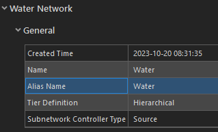

Can you verify that you are using a source and not a sink based hierarchical network.
SamDeLore
Hi Mike,
Yes, Source based.
