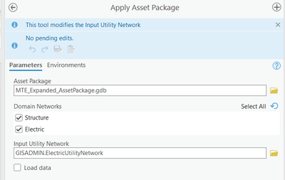

I've hit the identical error reported by BryanMay531.   I've selected both domain networks.   Is there a fix or work around for this?
Thx,
Ed

Paul -
Thank you.  That seems to have gotten me over that particular hump.
With that change my "Apply Asset Package" process ran nearly an hour and hit the error below.    Which I'm pretty sure is unrelated and merits its own question.  (FWIW - I don't have editor tracking enabled in the source asset package and it doesn't seem to be enabled in the target UN dataset.)
Thx
Ed
Adding GlobalID_1 to GISADMIN.StructureBoundary...
ERROR 000852: Cannot add field GlobalID_1 to GISADMIN.StructureBoundary
ERROR 002764: The field is used by Editor Tracking., The operation is not supported by this implementation.
WARNING 000952: Failed to execute (AddField).
EdwardBlair
The GlobalID_1 field was defined as a "GlobalID".  Once I removed this my "Apply Asset Package" task completed successfully.
Ed
