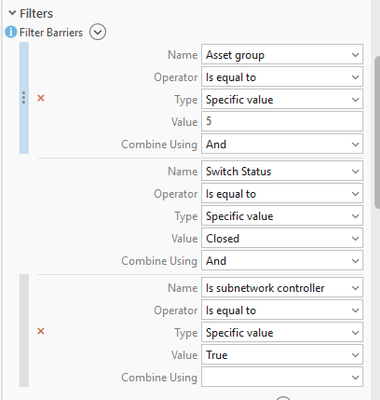

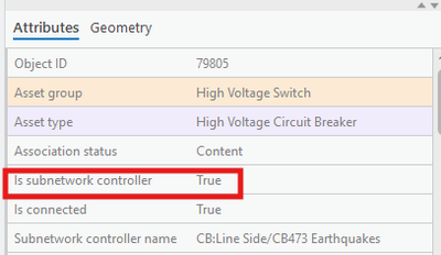

As a crude test, I tried this on our electric Network.
I can confirm it skips any devices that are not subnetwork controllers and selects the one where ISSUBNETWORKCONTROLLER = True

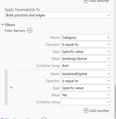

Are you able to share some screenshots of the devices being selected and the trace tool. That might help troubleshoot this further.
DonSanjeewaErangaJayaweera
@gis_KIWI4
Here is the filter barriers added

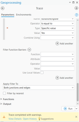

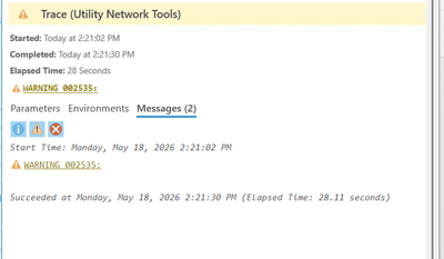

But it completes with a warning
This is a generic warning.
When I run connected trace I noticed sometimes the field IsolationEligible was working ok as a filter barrier.
RobertKrisher
Please open a case with support on this. Seeing a blank error message like that means something unexpected is happening.
