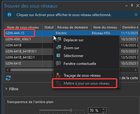

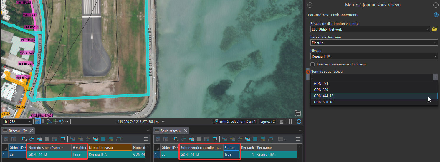

Ex: Here you can see that the same subnet has a status of False in the FC subnetline row (left) and True in the subnetwork table (right). And the Update Subnetwork toolbox allows us to update the subnet, unlike the "Find Subnetworks" panel (because I assume the tbx applies to the subnet table and the panel applies to the FC subnet row)

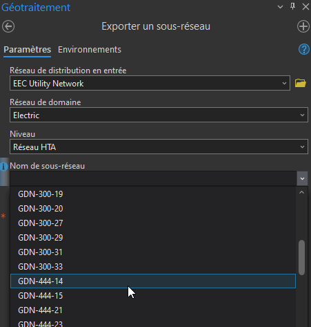

Also the Export Subnetwork does not propose this subnet (obviously because it is dirty) :

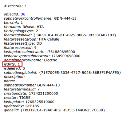

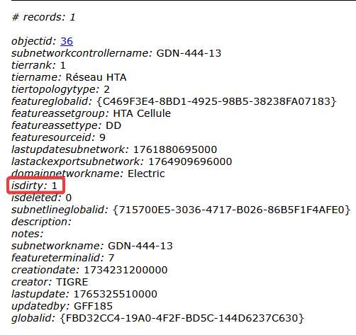

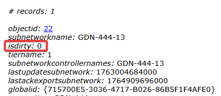

Looking at REST endpoints, I can see the same inconsistency:
SubnetLine :
Subnetwork :

@PierreloupDucroix you are correct in that the behavior is slightly different when posting edits from a version. If the subnetwork or subnetwork line is modified in the version we will mark it as dirty when it gets posted because we know that there are changes that happened to it in the version that mean it needs to be processed in default.
As an example, if you create new features in your version and run update subnetwork, they will have their subnetwork name populated and the subnetwork line will be updated to reflect the new features in your version. After you reconcile and post your version to default, there is no guarantee that those same features will be connected, so we make you rerun update subnetwork to ensure everything is clean and connected.

The subnetworks table is the more reliable way of determining status, especially in networks with multiple subnetwork controllers.
